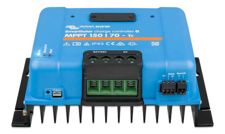

Is this your model? It should be labeled H (the right most terminal and the left port). Here is a mention in the manual:
3.11. Remote on/off
The solar charger is equipped with a remote on/off terminal. The solar charger can be turned on or off remotely by connecting a
switch to this terminal or by presenting a high signal to the H terminal or a low signal to the L terminal. Alternatively this terminal
can be connected to an external control device, for example a lithium battery management system (BMS).
There a several ways to turn the solar charger on using the remote terminal(s):
• The L and H terminals are interconnected connected via a switch or relay.
When the voltage on the H terminal is more than 2.9V (up to the battery voltage) via a switch, relay or other external device,
like a battery BMS.
• When the voltage on the L terminal is pulled to battery minus. (<3.5V) via a switch, relay or other external device, like a battery
BMS.
A virtual remote on/off terminal can be created by using the VE.Direct non inverting remote on/off cable.
The functionality can be programmed using the VictronConnect App RX port function settings.

Thanks again, nebulight -
That image is not in my manual, version 01 dated Feb 12th 2018.
This image is in my manual and depicts my MPPT, although not the same model. My 150/70 vs shown 150/85. All else identical.
It's hard to see, but the furthest right terminals on the bottom are labeled Remote. The right hand side is also labeled +. The left side has no label. There is no L or H. There has always been the short jumper wire connecting the two sides.
The manual text is as follows:
3.5 Remote on-off
The left terminal is connected to the internal 3,3V supply, with a resistor in
series for short circuit protection.
The right terminal (marked as +) will switch the controller on if >3V is
applied, and will switch the controller off if <2V is applied or if the terminal
is left free floating.
The recommended use of the remote on-off is:
a. A switch wired between the left and right terminal
b. A switch wired between battery plus and the right terminal.
c) A switch between the right terminal and the charge disconnect terminal of a VE.Bus
BMS
Clearly, my component is very different than your image. This difference has to be the root of my problem.
