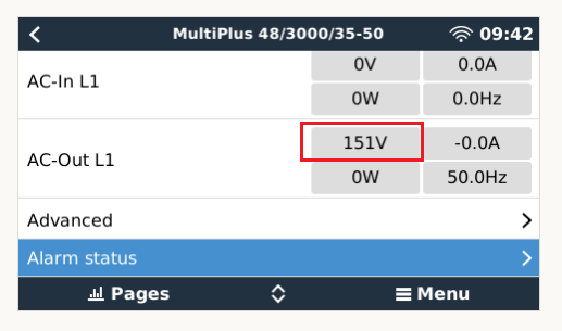

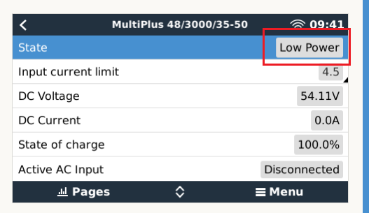

I have a client with a Easysolar 5kva (multiplus 5kVa). Stand alone, lead acid batteries.
System has been working for several months. AC output is locked at 151V. I have checked & Re Entered settings in VE Config to ensure output is set to 230V.
State on Colour Control is "Low Power".
Batteries are fully charged and in good condition.
See Screenshots below.
Any Idea's?
