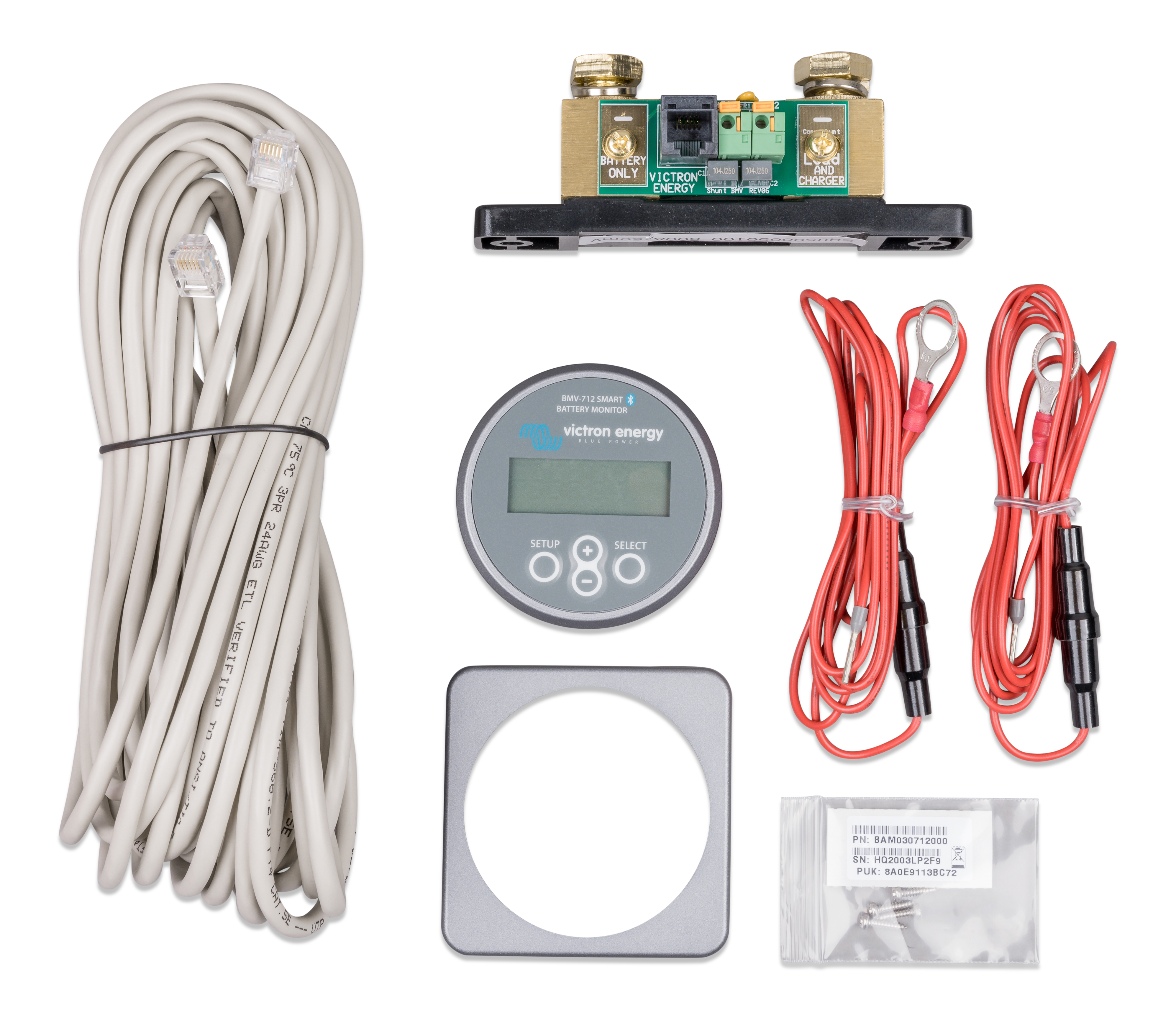

klim8skeptic avatar image klim8skeptic ♦ commented ·
@mewgaf Didnt the 712 come with the square mounting bezel ??
Quick install guide.
