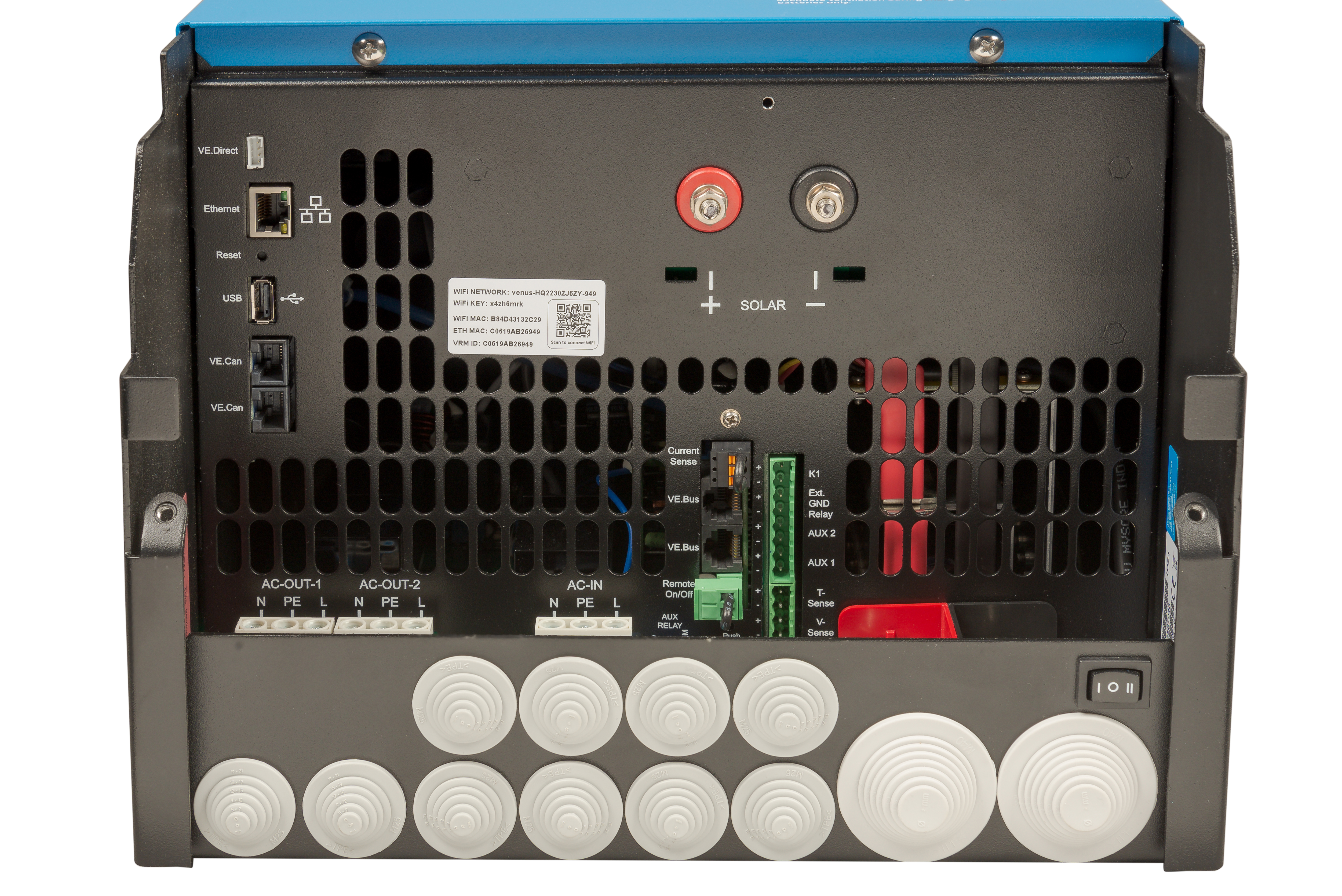

I recently started to work on a future setup for my new boat (where I live). I plan on using a Easysolar 2 GX with a 1.6Kwp PV and a DC/DC Orion to charge via the alternator.
Is it possible to connect a BMV 712 via V.E direct to the Easy Solar 2GX? I wanted to double check because it is stated in the manual that there's 1 V.E direct but the MPPT built in is via V.E direct.
Also, in the manual of the Easysolar 2 GX, they talk about a "battery monitoring" system, is it "kinda" the same as the BMV series? I mean % battery, Ah consummed etc...
The whole electrical system will be in the bilge and I would like to have a visual clue without having to open the bilge or checking my phone (even though I love the Bluetooth functions and the VRM) that's why the BMV. It is possible and may it cause troubles to the battery monitoring built in the Easy Solar 2 GX?
