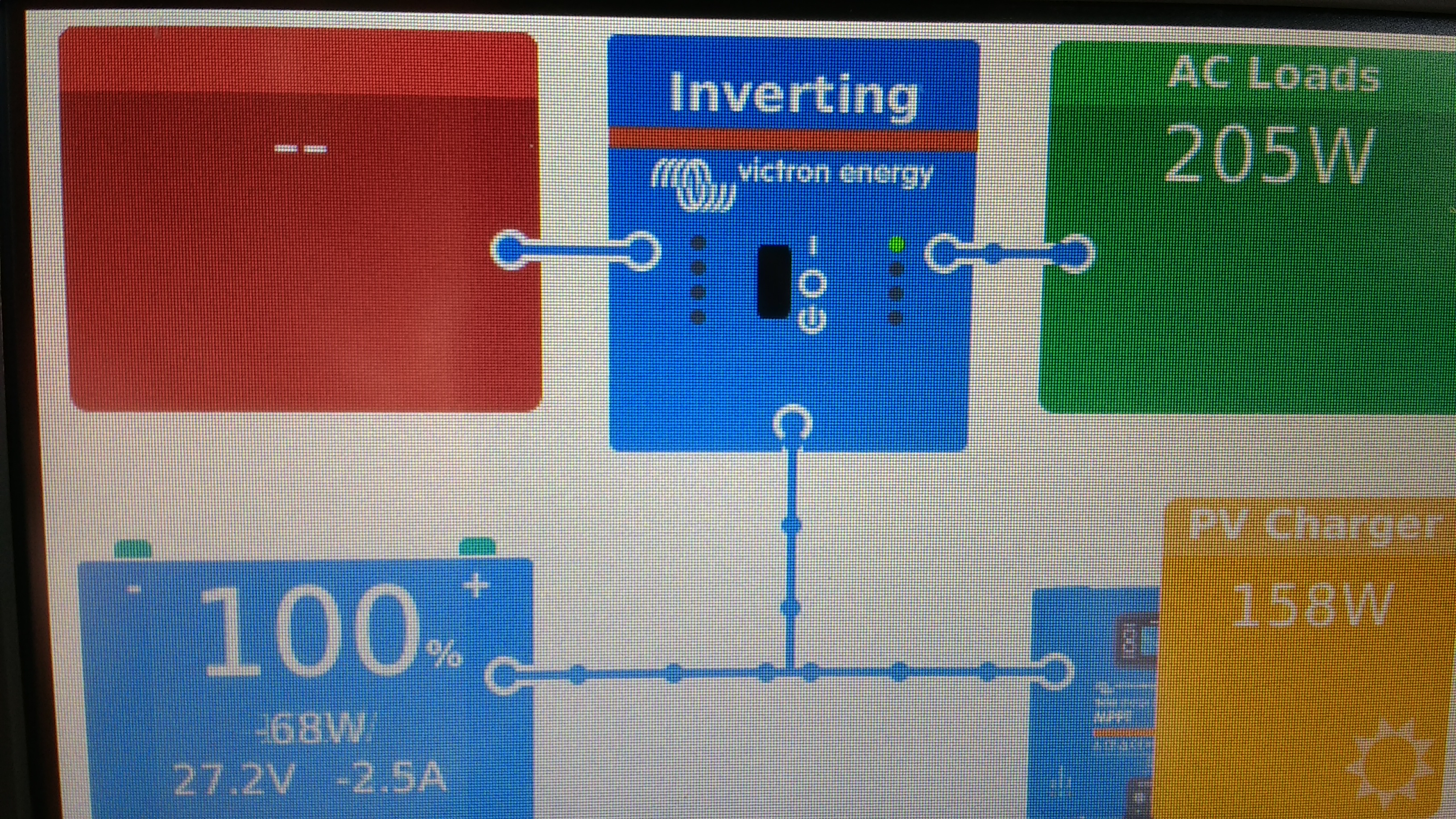

salv answered ·

Display tiles red box is usually named generator

Alexandra avatar image Alexandra ♦ commented ·
@Salv
You have some set up to do. There are so many more options now.
You would need to go into the menu - settings -system setup and choose/set your input there.
0 Likes 0 ·
salv avatar image
salv answered ·
It's set AC1 to Generator as before, still nothing

JohnC avatar image
JohnC answered ·
@Salv
It should show Generator when the gen is running. That's like a generic tile, and if you were running a Quattro it would show whatever ac input is being used at the time. If none in use, then you get the '--'.

salv avatar image salv commented ·
So different than before as the tile was labelled as Generator even when not running, I check when on next run time and see if anything changes thanks JohnC

Dave Rae avatar image
Dave Rae answered ·
Yeah I agree the TILE should still show the appropriate label it’s configured for, and an ON/OFF label to round it out. That would make more sense, instead of (what’s that big red TILE for). In the VRM the label (GENERATOR) is displayed even if its no running, would be nice to have the same graphical config on the CCGX/CERBO displays.
That's how it was before update just labelled Generator even when not running.
