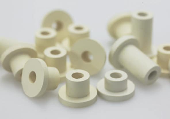

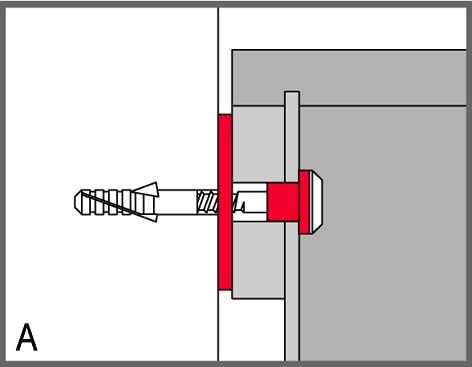

Unfortunately, I can only agree with the general criticism. The volume of the multi and its fan are absolutely incomprehensible.
As for the toroid's "fixation": I can understand why it sits so rigidly on the case. Since Victron also installs these systems in vehicles, swinging masses would not be a good idea.
But
Since more and more systems are operated in "fixed" accommodations, another type of mounting could be used for this. My house, at least, has hardly moved in the last months ;)
However, this does not excuse the use of such a pulsed fan ...
I operate my Multi Plus 2 in lying and open form ... Please no comments about warranty and so on :)
Furthermore, I have removed the toroidal core and stored oscillating ... Carpet pad for washing machine etc. and inserted again
Simply with a 68ér hole circular saw cut out the round upper part and the "rest" with hole under the toroid.
The nuisance is extremely low ... you hear the fan much more than the transformer

I've mounted the Multiplus II 48/5000 with vibration isolation, modifying slightly the mounting plate, enlarging a bit the holes and then using such rubbers:
around the bolts, with flat washers for peace of mind, and a 2cm rock wool insulation mat (not burnable) behind the plate and at bottom has significantly reduced the vibration transmission and the noise propagation of the relays to the rest of the house.
The mounting I did was something like this (but significantly wider in the back, which allows for backside venting as well, allowing fans to stay off at slightly higher load):
Important: make sure that the bolts of the mounting plate do not touch the case of the MultiPlus II as touching nullifies the solidian sound and vibrations insulation from the wall.
At least, this mounting won't have any effect on the warranty of the unit itself.

Hi - i'm trying to replicate what you have done. However i'm struggling to find any washers like that in the UK, and also not sure what you mean by 2cm rock wool ? I cant really find anything like that. I was thinking about using anti-vibration washing machine mat ANTI-VIBRATION Rubber MAT for Washing Machine & Tumble Dryer 600MM X 600MM | eBay
Is that similar to what you have used behind the mounting board?
0 Likes 0 ·
dancrompton avatar image dancrompton subby28 commented ·
You can find them in the UK by searching for 'rubber well nuts'.
https://www.ebay.co.uk/itm/224153652175
0 Likes 0 ·
subby28 avatar image subby28 dancrompton commented ·
I ended up looking for shoulder washers which were nylon. The ones you have linked have a nut in which would need drilling out, and I'm not sure the larger diameter rubber part is big enough.
0 Likes 0 ·
I bought some but didn't use them. They are probably more than sufficient to hold a Multiplus, but didn't have enough confidence in them to use them.
0 Likes 0 ·
beat avatar image beat subby28 commented ·
@Subby28 Rock wool = compact thermal insulation material. Search e.g. for "rock wool compact insulation 30mm". The advantage of rock wool compared to anti-vibration matts, is that it is classed as highest fire-resistant material (it's actually used for fire-walls), but from a sound perspective, any anti-vibration absorbing material will do. Regulations here are that electric apparatus should be mounted on fire-resistant materials, so I didn't use rubbers.
0 Likes 0 ·
marekp avatar image marekp subby28 commented ·
