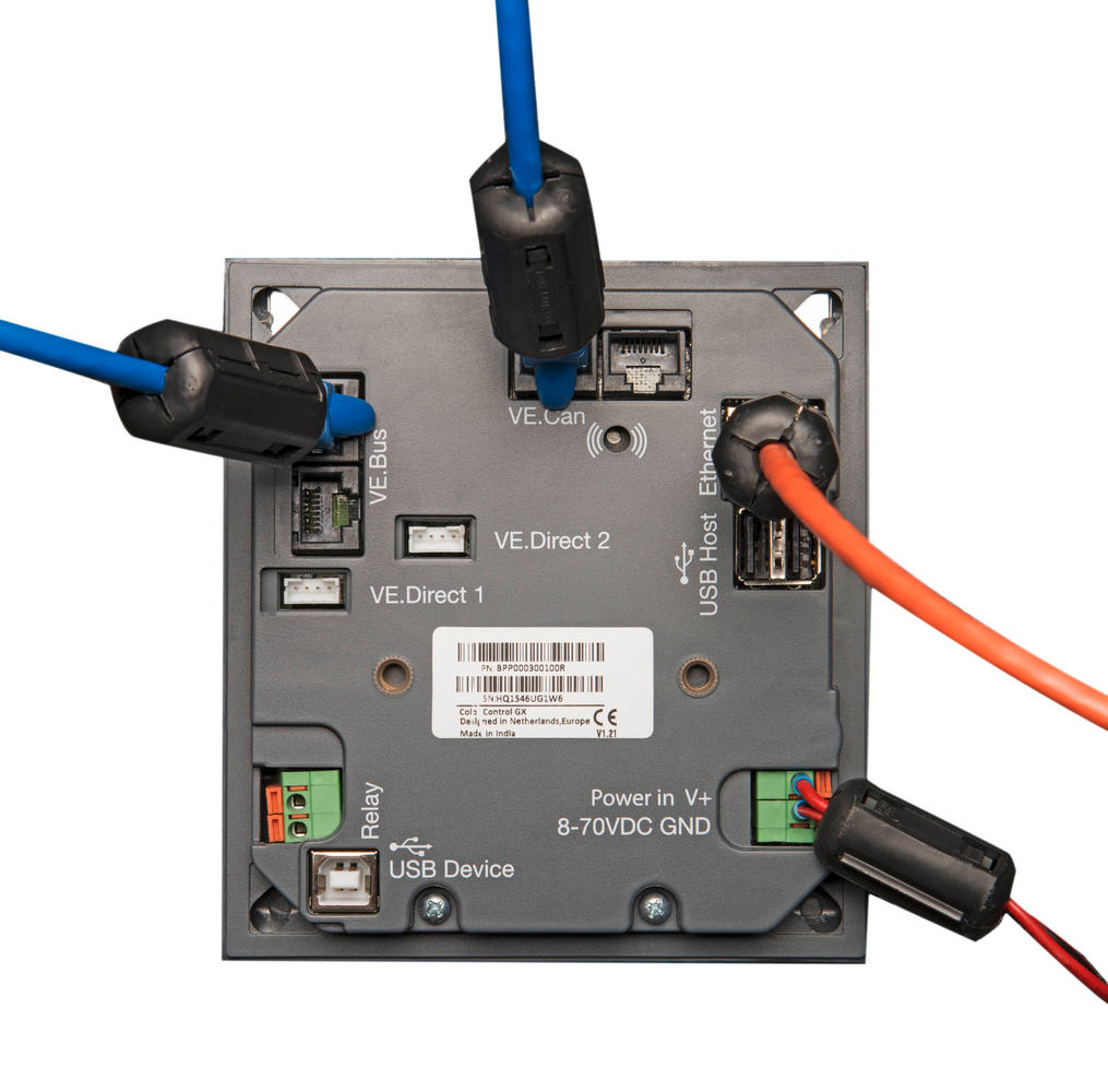

i have a yamaha efi gen with an autostartmodule installed, can cross the 2 wires to start the gen, disconnect to stop...inside the easysolar there are a number of ports aux 1 aux 2 etc, which one do i plug the 2 wires into for the gen start/stop

It rather does depend on your programming on the Victronbif you want to use the inverter relays.
The easiest setup is the GX color control though using the relay at the back. Then you can interact with the generator from the screen.
https://www.victronenergy.com/media/pg/Venus_GX/en/gx---generator-auto-start-stop.html
https://www.victronenergy.com/upload/cache/1580827279_upload_documents_1550_1000-Color%20Control%20backside%20with%20cables.jpg
