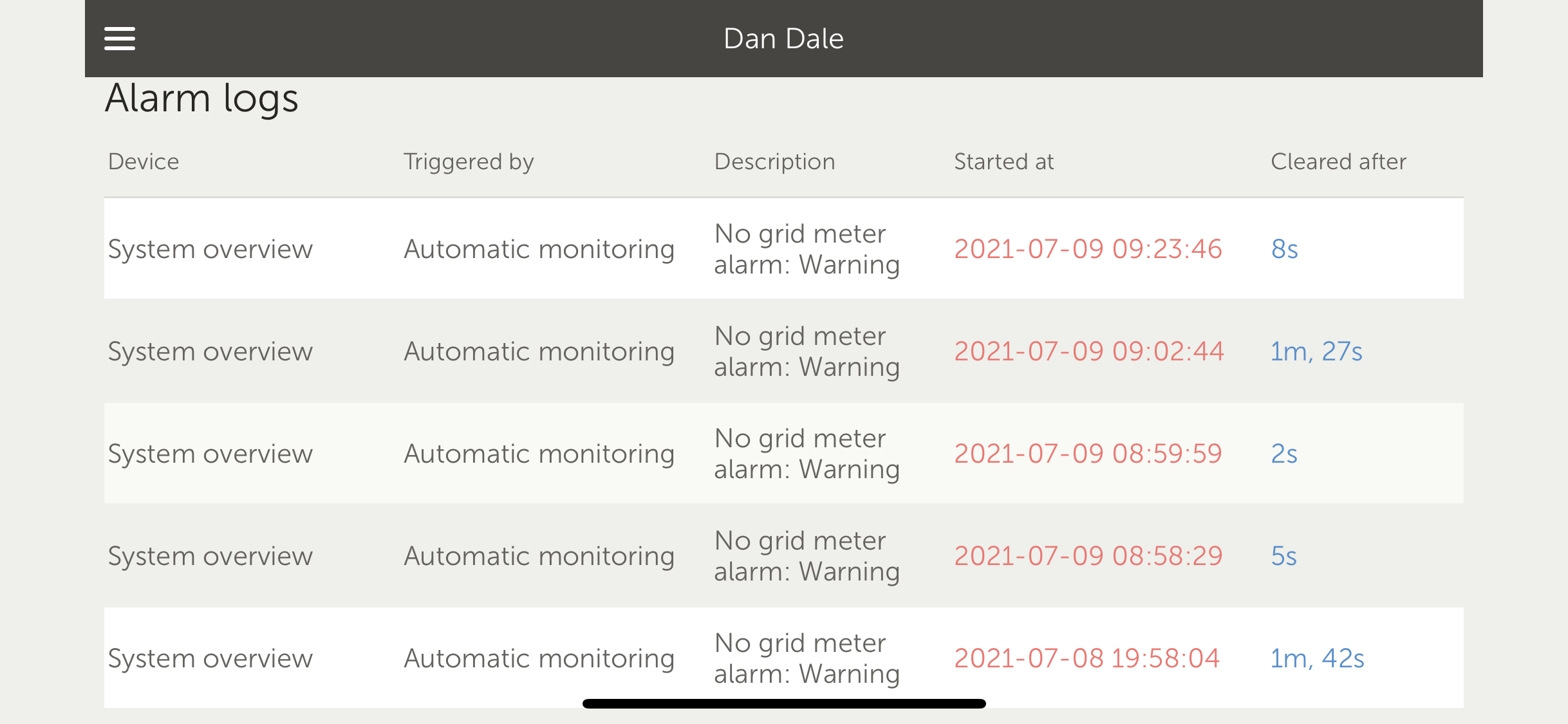

No grid meter alarm: Warning - Using Zigbee wireless
45b315d6-d108-4bab-a73e-630d4b72d74c.pngCCGX v2.72
Multiplus
ET112
Zigbee wireless modules. USB
Could anyone shed some light on the never-ending (daily) error please? Losing lots of usage data and when this error occurs we don’t benefit from the energy generated. All generation is exported to the grid and not even the batteries are recharged during this error/event. House has to import rather than use the free energy.
TIA.
“No grid meter alarm: Warning”
CCGX Color Control
2 |3000

See my thread here. https://community.victronenergy.com/questions/91822/ccgx-venus-os-266-frequent-grid-meter-warningalarm.html
I believe the problem is related to the CCGX.
