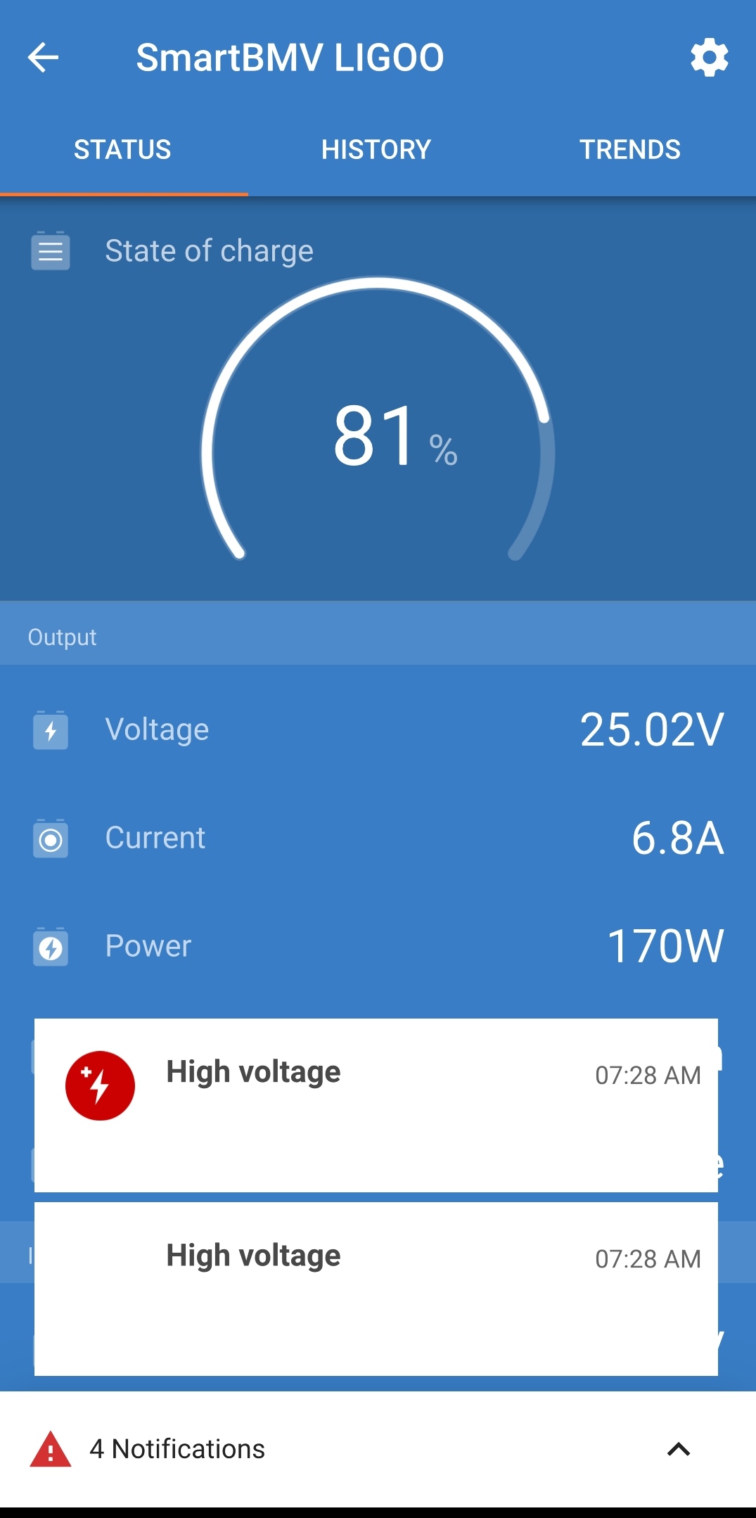

BMV has been triggering high voltage alarm over the last 24 HRS yet I see battery voltage to be normal

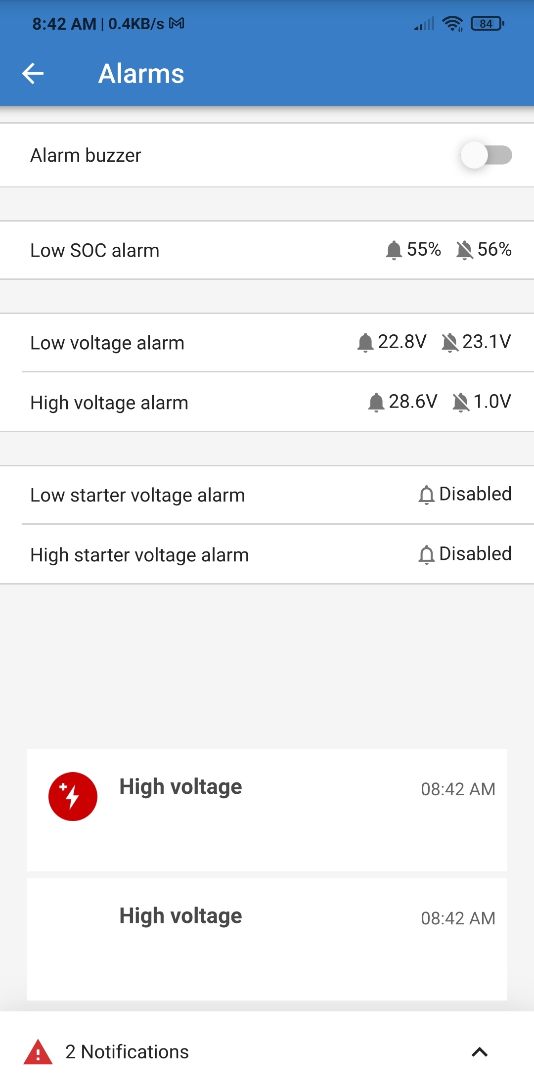

The high voltage alarm clear value is set to 1V, this is the voltage that the battery needs to get to clear the alarm.
Tap the High voltage alarm, and set the Clear Value to 28.4V
Then when the battery voltage falls below that value, the alarm will stop.

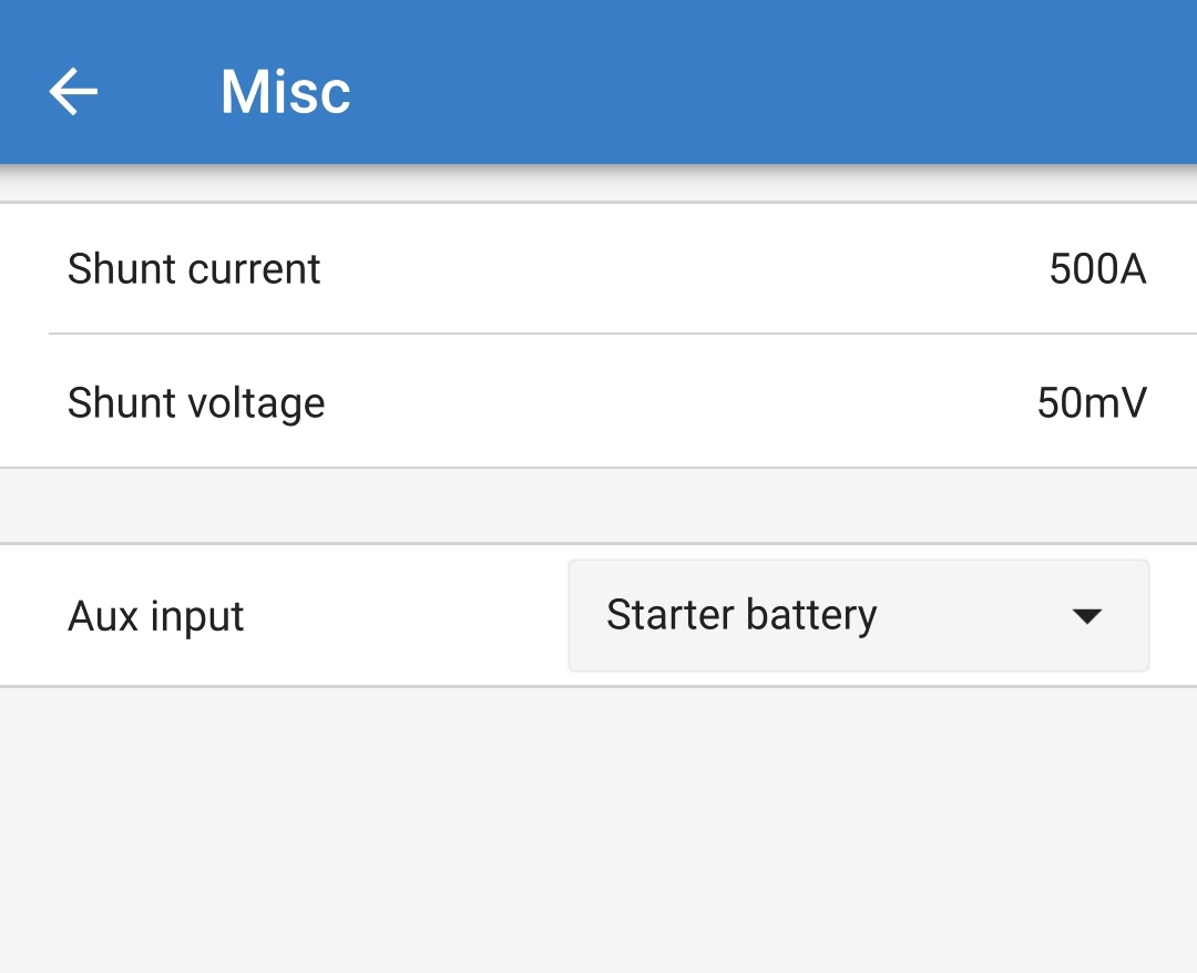

Check the BMV settings in VictronConnect, in the Misc menu, to make sure that the Aux input setting is correct. For example if you have the battery mid-point selected, but wired across the full bank (instead of the midpoint of the battery) you will get an alarm.

BMV Misc settings are as in pic
And here are my alarm settings
