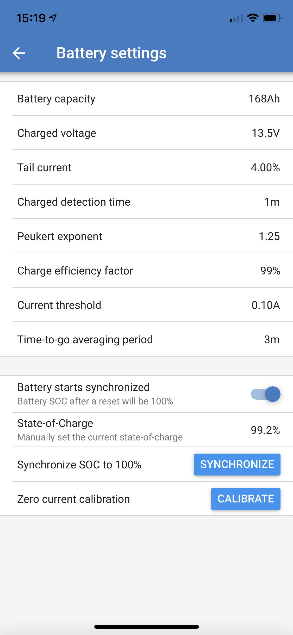

I didn't have any trouble setting the peukert to 1.05. Perhaps you can try again.
Hi
Thanks for the reply.
So are you saying i should set the charged detection time to 3 mins, & change the Peukert to 1.05?
That looks good for the BMV settings.
(BMV) Charge voltage of 13.7-13.9v (depends on how much current the chargers can supply) and tail current of 2-3%.
Keep the chargers on their default Li charge settings for now, until you know what each is capable of achieving.
See how that goes for a week, and report back.
