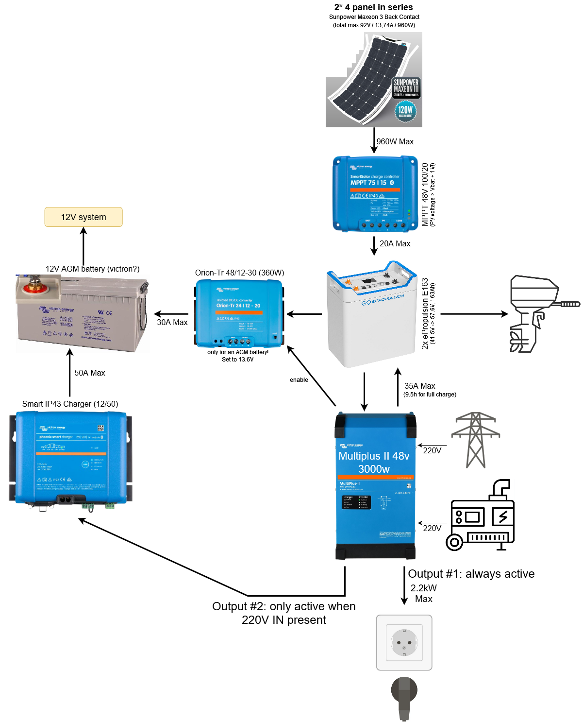

Hello all!
I'm currently designing the electrical setup for a friend's boat and discovered this forum. I therefore was wondering if the community was so kind to review what I had in mind?
thanks!
