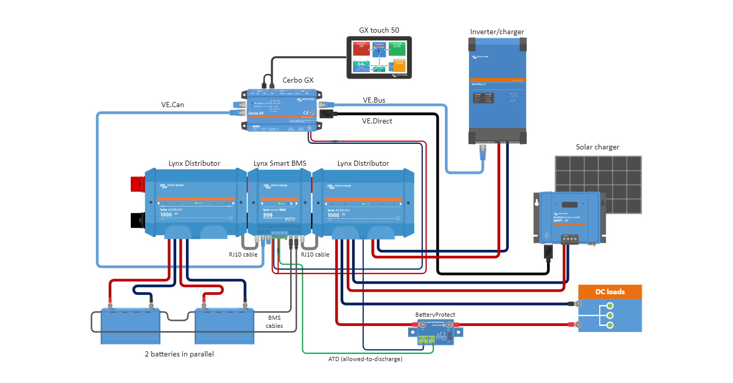

The key objective here is to install a singular system that is entirely DC Coupled to a unit or cluster of units that can take any DC supply and route it to where it is required. Whether to grid (while on-grid) and site loads or to battery, or all of them simultaneously.
The point in this design is that no AC Coupling is required or even recommended and loads can be supplied from PV without drawing from the battery: unless not enough PV power is available.
Is this design achievable using Victron components?
