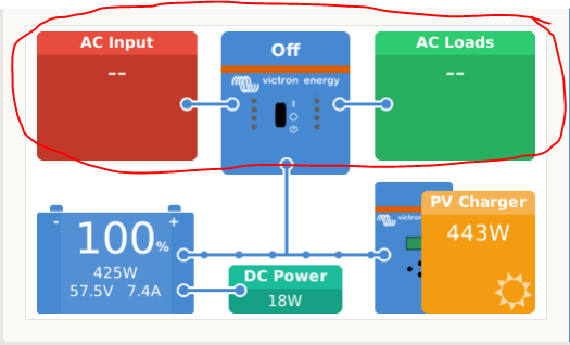

Is it possible to remove the "AC side" from the display in a DC system with only a CCGX, BMV and MPPT?
This site is now in read-only archive mode. Please move all discussion, and create a new account at the new Victron Community site.

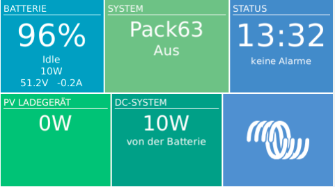

No, unfortunately this is not possible.
You could switch to tile view, so it would be possible to have it like that:
Regards,
Markus
