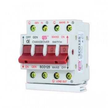

4) Using a 1-0-2 switch to select the source for critical loads between grid and MP2-Out1 always produces a short gap. It cannot replace the nonstop switch with external contactors.
