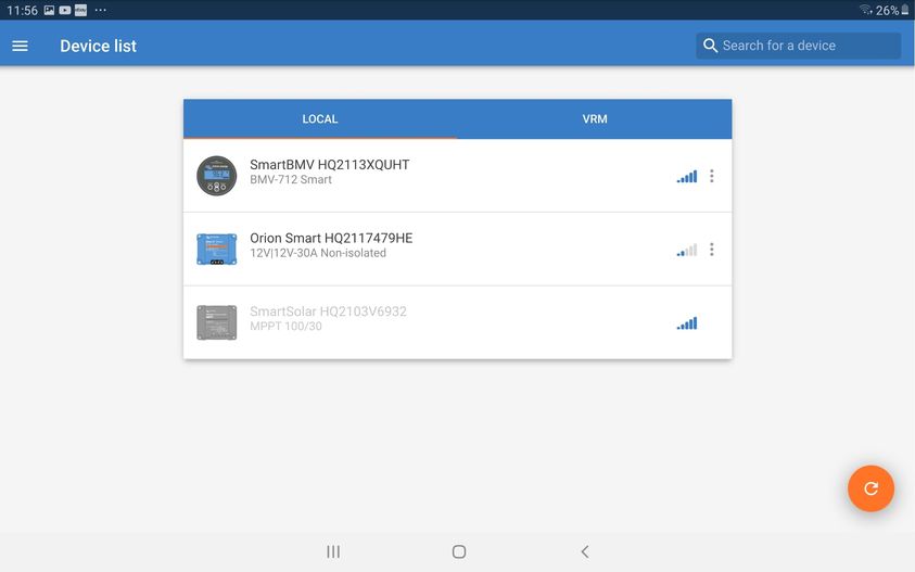

To do a power cycle you have to disconnect all wires and reconnect them (battery first).
Hi
You should indeed power cycle the MPPT as said above by Matthias. Besides this, what VictronConnect version do you use? This issue should be fixed in a firmware update that was included in VictronConnect v5.53.
